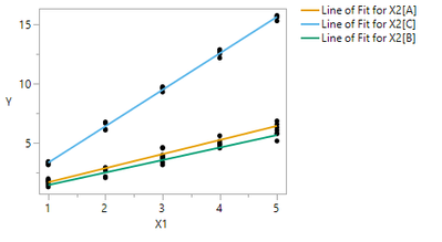

an intercept and a slope (over X1) per categories of X2., like in the following graphic:

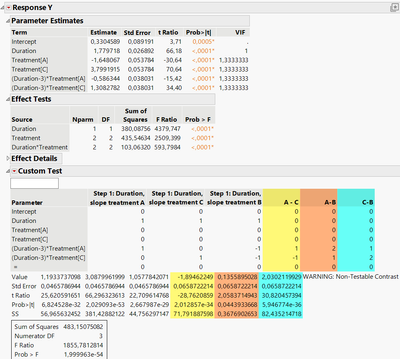

For now, in JMP I only found ways to do very close things but not exactly what I want :
1. Fit model appraoch: Compare Slopes with Overall Average
--> Red Triangle / estimates / Compare slopes
This compares each slope to the avergage slope (with a Nelson adjustment)
2. Fit curve approach: Equivalence Test Results
--> red triangle (from linear fit) / Equivalence test
This approach performs pairwise (accross categories of X2) equivalence tests for each parameters of the fit. here, there are only 2 paramters, the intercept and the slope.
