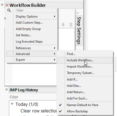

If I have a workflow included in another workflow
I can right click on the included workflow and import it, then in case there is also an included one, you can do it again
which would then (if it is the final sublevel open all steps of that included workflow:

Hi Martin, I don't want to include the workflow, I want to open it - to make tiny changes and save it.

ah got you, editing of the included workflow would be possible in my approach but not saving the changes I made back to the included workflow itself, just to the final workflow (incl. the included workflow). Agree it would be a nice option to "save included workflow" or "open included workflow outside workflow", of course with a better wording ;)

It's not just about 'fixing errors'.
Fun fact: if there is an error in the included workflow, JMP will stop while running it and the workflow will stay open. This is similar to the 'open' functionality, which I miss, but you need an error in the included workflow to access this feature.
Besides debuging, it's also about understanding an existing master workflow and taking a look at an included workflow to see what's going on.
Some users may be familiar with LabVIEW and its sub-VIs. Workflow Builder, with its ability to include other workflows, is like a draft version of this concept. Error handling is already included.
The ability to open an included workflow will give the users even more of the work-with-subVIs-feeling.
  Workflow Builder - open included workflow
The ultimate step towards subVIs:
a framework for input and output variables.
