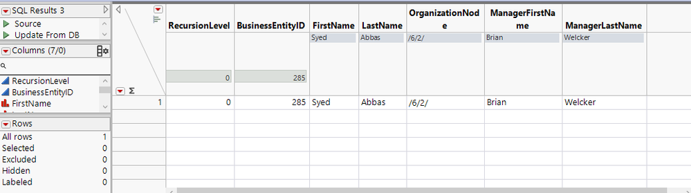

The syntax is a little different for SQL Server. In the example below, I'm asking the AdventureWorks2019 database (a standard one supplied by Microsoft) to execute the stored procedure "USPGetEmployeeManagers" for BusinessEntityID 285 (a person named Syed Abbas). The script returns the table in the screenshot.

Hi Jed - I appreciate the detailed response, including an example with an SP parameter.  I'll assume that if the SP returns multiple rows for a given set of parameters, that can be dealt with efficiently within JMP.
Re: How to Call SQL Server Stored Procedures in JMP 18.1.1
Yes, the JMP table captures however many rows the query sends back.
