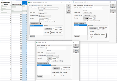

To understand these easier, I think it is beneficial to just write them all out as separate ones and to make them easier to understand, in this case:
  1. First column with Col Max(:height, :age, :sex) (max_height_for_agesex)
  2. Next column then utilizes that Col Min(:max_height_for_agesex, :age) age_minmax_age
  3. And the final one is the comparison of these two :max_height_for_agesex == :age_minmax_age
