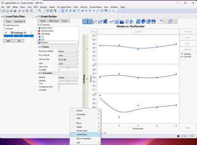

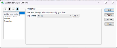

Hi @Neo ,
  I would do as @hogi suggested and use the Customize option when you right click on the graph of interest, click on the the "+" to add a new script to GB, then type in the JSL for adding in a line.
  Now, to have this dynamically respond to the local data filter, I think would be more challenging. If you need that kind of functionality, I would instead generate my own report window that has graph builder built into it and then maybe use check boxes to give the user options of updating the subplots with reference lines when they select the different TestStage check boxes.

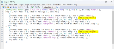

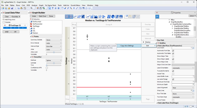

  I did figure out a way to change the nested line color as well. I don't know if this is the "correct" way to do it, or even if it's the fastest way, but if you right click on the nested axis and then select show properties, if you click on the nested axis and then click the red hot-button next to AxisBox, select Copy Axis Settings, you can then paste it into a scripting window and edit it. Select the axis of interest, and change the Line Color from "None" to whatever color you want. You then have to copy this edited code, go back to the red hot-button, select Paste Axis Settings, and it will update the graph. This will get the job done, but I'm not sure how this can be done dynamically.
  Saving the corresponding script to a scripting window, you can see the commands you need to send the Graph Builder and Label Row in order to get the outcome you want.

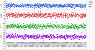

  Using this bit of information and coming back to your original post using the Semiconductor Capability.jmp file, you can achieve what you were originally asking for, the nested axis is purple, the vertical grid lines are purple and there is a reference line only for the bottom-most graph. In this particular case, double clicking the axis that you want to add the reference line to will work because you are plotting different columns in the subplots of graph builder. For the example data table that you shared, you have to do it the other way with Customize, and adding a Y Function().
  Here is the JSL code that generated the above graph. You can see where you need to make the appropriate edits for your specific case.
Names Default to Here(1);
dt = Open( "$SAMPLE_DATA/Semiconductor Capability.jmp" );
dt<<Graph Builder(
	Size( 752, 515 ),
	Graph Spacing( 4 ),
	Variables(
		X( :SITE ),
		X( :lot_id, Position( 1 ) ),
		X( :wafer, Position( 1 ) ),
		Y( :NPN1 ),
		Y( :NPN2 ),
		Y( :PNP3 ),
		Y( :PNP1 )
	Elements( Position( 1, 1 ), Points( X( 1 ), X( 2 ), X( 3 ), Y, Legend( 50 ) ) ),
	Elements( Position( 1, 2 ), Points( X( 1 ), X( 2 ), X( 3 ), Y, Legend( 51 ) ) ),
	Elements( Position( 1, 3 ), Points( X( 1 ), X( 2 ), X( 3 ), Y, Legend( 52 ) ) ),
	Elements( Position( 1, 4 ), Points( X( 1 ), X( 2 ), X( 3 ), Y, Legend( 53 ) ) ),
	SendToReport(
		Dispatch(
			"SITE",
			ScaleBox,
			{Label Row(
				3,
				{Line Color( "Purple" ), Major Grid Line Color( "Purple" ),
				Show Major Grid( 1 )}
		Dispatch(
			"PNP1",
			ScaleBox,
			{Add Ref Line( 300, "Solid", "Black", "", 3 )}
Hope this helps!,

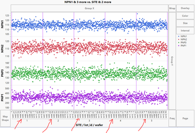

nice idea to link the vertical lines and the axis labels via color :)
Unfortunately, the lines are soo thin that it's difficult to notice the feature.
If you have the same feeling, please support this wish:
optimized graphics settings for hierarchical X categories - 2 options

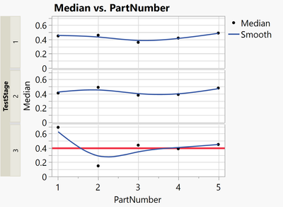

hogi

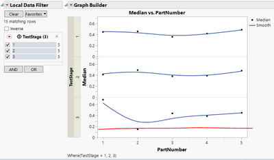

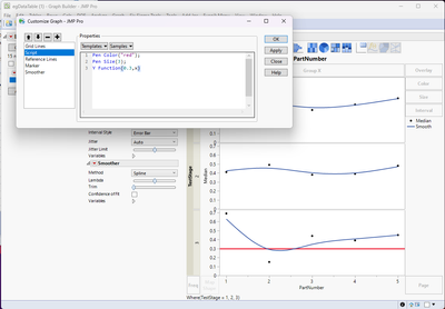

Level XIII
Re: How to (1) change default color in AxisBox and (2) add reference line in only one Y-axis variable in grouped Y plots?
This the easy case where due to the Y Group the graphs are split into different FrameBoxes. Then you can just add individual Reference Lines via Customize.
Graph Builder(
	Y Group Edge( "Left" ),
	Variables( X( :PartNumber ), Y( :Median ), Group Y( :TestStage ) ),
	Elements( Points( X, Y, Legend( 33 ) ), Smoother( X, Y, Legend( 34 ) ) ),
	SendToReport(
		Dispatch(
			"Graph Builder",
			FrameBox( 3 ),
			{Add Graphics Script(
				2,
				Description( "" ),
				Pen Color( "red" );
				Pen Size( 3 );
				Y Function( 0.4, x );
Graph Builder(
	Size( 592, 526 ),
	Graph Spacing( 4 ),
	Variables(
		X( :TestStage ),
		X( :TestParameter, Position( 1 ) ),
		Y( :Median ),
	Elements(
		Points( X( 1 ), X( 2 ), Y, Legend( 33 ) ),
		Smoother( X( 1 ), X( 2 ), Y, Legend( 34 ) )
	Local Data Filter(
		Conditional,
		Add Filter( columns( :TestStage ), Where( :TestStage == {1, 2, 3} ) )
	SendToReport(
		Dispatch(
			"TestStage",
			ScaleBox,
			{Label Row( 2, Line Color( "Purple" ) )}
		Dispatch(
			"Graph Builder",
			FrameBox( 3 ),
				2,
				Description( "" ),
				Pen Color( "red" );
				Pen Size( 3 );
				Y Function( 0.3, x );
dt<<Graph Builder(
	Size( 752, 515 ),
	Graph Spacing( 4 ),
	Variables(
		X( :SITE ),
		Y( :NPN1 ),
		Y( :NPN2 ),
		Y( :PNP3 ),
		Y( :PNP1 )
	SendToReport(
		Dispatch(
			"SITE",
			ScaleBox,
			{Label Row(
				3,
		Dispatch(
			"PNP1",
			ScaleBox,
Hope this helps!,

Neo
Neo
Level VI
@SDF1  Thanks. I will check how you managed to change the color of the nested axis to purple. Meanwhile I used @hogi  suggestion and Make Filter Change Handler () to dynamically change the where JMP puts the reference line as the user changes filter selections. I haven't resolved two issues with this yet.
1. The filter change handler does not trigger when the chart is plotted the first time but only when the next TestStage is selected.
2. When the filter is changed the earlier reference line remains on a different test stage, which I understand why, but haven't been able to remove it yet.
Names Default To Here (1);
clear log ();
gb = Graph Builder(
	Local Data Filter(
		Conditional,
		Add Filter( columns( :TestStage ), Where( :TestStage == {1} ) )
ldf = Current Report()["Local Data Filter"] << get scriptable object;
getTestStage = Function( {this}, //print (this);
                          testStateFiltered = Associative Array(:TestStage [ldf << get filtered rows]) << get keys;
                          gb << SendToReport(
								Dispatch({},"Graph Builder",
								FrameBox(N Items (testStateFiltered)), {Add Graphics Script( 2,	Description( "" ), Pen Color( "red" );	Line Style ("dashed"); Pen Size( 0.25 );
											Y Function( 0.2, x );
                          show (N Items (testStateFiltered));	 Print(testStateFiltered);
rs = ldf << Make Filter Change Handler( getTestStage() );
