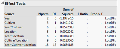

I have been asked to analyze multiple main effects and their various interactions, but don't think I can do so as I achieve Lost DFs error messages when I use the Fit Model analysis. In case it helps, here the details of the data. Main effects (size): Location (4), Cultivar (4), Region (2, 2 Locations grouped per region), and Year (3). I only get results/appear to have enough DF when I run any two main effects maximum, but never with an interaction.
Question 1) Do I have a degree of freedom issue in terms of not being able to analyze more than two main effects, hoping to look at all four?

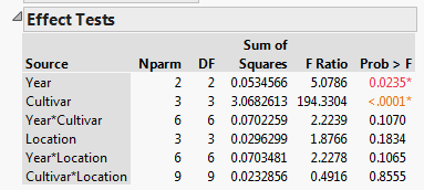

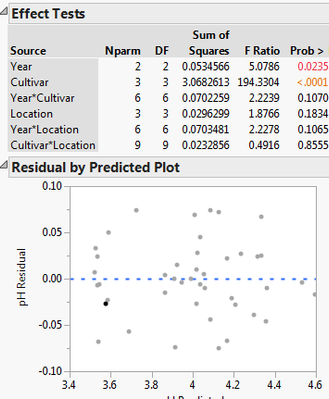

Here is some output from the Fit Model (Personality: Standard Least Squares, Emphasis: Effect Leverage) with a Full Factorial minus the three way interaction. Looks pretty good, just not able to test the three-way which may not be significant.

A rule of thumb that I've always used is that you need 1 degree of freedom for each term in the model that you are trying to run plus 1 additional one for the intercept - minimum.  This rule will not allow you to estimate the error terms in your model, so you will need additional degrees of freedom for that.
From the first table it appears that you are trying to describe a model with 10 terms (including the intercept) and only have 7 or 8 rows in the data table.  This means that you are attempting to propose a model that would be supersaturated.  In such cases, partial least squares can be helpful, and you might want to have a look at that option under Analyze > Multivariate Methods > Partial Least Squares.  Otherwise, you don't appear to have a sufficient number of observations to do what you are proposing.

I have no replications, a very weak observational study. For the response variable of Acidity for example, I have 48 observations but that is split among 4 locations, 4 cultivars, over 3 years (48/4/4/3 = 1). I did re-analyze the data with some changes (fixed some user errors) and have been able to test three of the four main effects and two way interaction as seen below, but not the three way interaction.

Full Factorial:  (Fit Model, Personality: Standard Least Squares, Emphasis: Effect Leverage)
Full Factorial minus three way interaction:
