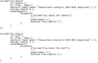

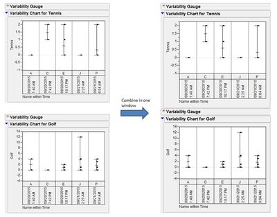

When I run this script, the charts will come out with separate window. How can I modify the code to make it merge to one window with both charts?
Your helps is appreciated!
Merge both chart in one window.

A simple method would be to use New Window().  Put both variability charts into the argument and it should combine them into a single window:
New Window("My Report",
     Variability Chart(...);
A example using JMP sample data is below.

One way is to encapsulate both platform function calls within a display box object that can hold both, for example V List Box. See below for an example.

Variability chart supports multiple Y that appears to be treated independently. The below command yields an identical output as the New Window approach (except for the window title):
dt << Variability Chart(Y(:weight, :height), X(:age));
