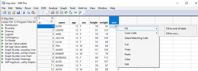

How does one copy the same data down across several rows?
You know how one can drag or double click to copy a cell down to the end in Excel. Is there an easy way to do that in JMP?
Or is the best way just to type up my data in Excel which is much easier/faster for me?
2 ACCEPTED SOLUTIONS
txnelson
Re: How does one copy the same data down across several rows?
Just right click on the cell you want copied, and then select Fill, you will be given 2 options....
Jim
To add to what Jim posted: the choices JMP presents to you when you right-click depend on the data you've selected. For example:
If you've selected the first few terms in an arithmetic or geometric sequence, JMP will offer to continue (or, alternatively, repeat) the sequence.
If you've selected a range of cells where there are "gaps" of missing values, JMP will present an option to replace the missing values with previously encountered values.
