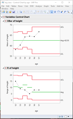

I have a formatting issue where at the bottom of a Control Chart i have a message with "Note Sigma was specified during launch" in the bottom left hand corner. If I right click I can select to hide it. Unfortunately i have many charts with the same message.

Here is a simple example of how to programmatically delete the text
names default to here(1);
dt=open("$sample_data/big class.jmp");
cc = Control Chart( Sample Label( :age ), KSigma( 3 ), Chart Col( :height, XBar, R ) );
report(cc)[TextBox(3)]<<delete;

If you could provide the script and/or an image of the output it would help in determining the best way to reference the Text Boxes that need to be delete/hidden
Manipulation of the Display Tree output is documented in the Scripting Guide.  I recommend that you read that document so that you can understand why the statement works to delete the text box.  You probably could get a pretty good idea on what it would take to delete all of them also.
