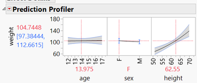

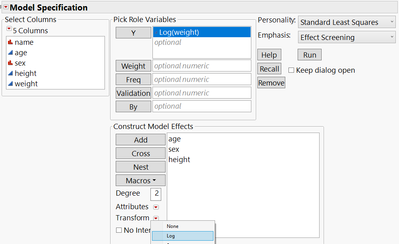

In Fit Model you can select your (original) response and then the red triangle menu next to Transform and choose log transformation. This will model the transformed response against the input variables and give predicted values and confidence intervals on the original scale.
