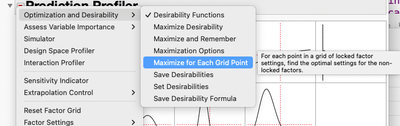

I think what you're looking for is the Maximize for Each Grid Point option.
Results:
-Jeff

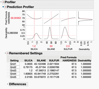

The Maximize each data point will work thanks!  Right now for my values 0-2 it's doing, 0, 0.5,1,1.5, and 2.  Is there a way for it to take smaller steps?
Jeff_Perkinson
Re: How do you script optimization of JMP formulas and save the results?
There's no way to get more grid points directly.
However, the grid points for continuous factors are determined using the min/max of the axis on the factor. So, you can adjust the axes and repeat the command.
This may take you back to your scripting request and the need to create all the combinations of the axes of all your factors but that's probably easier than scripting the grid generation for all the factors for yourself.
