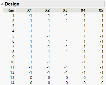

Did you consider any other designs? Do you need to isolate the effect of each factor in each group?
Custom design for the same main effects model would be larger but all the effects are separately estimable. Here is one candidate with 2 center points added.

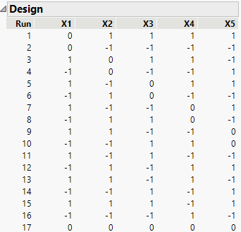

A definitive screening design might be more appropriate for the same goal.
