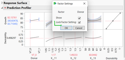

Since there are interactions, I'd be tempted to utilize your solution 1, and treat the donor as a factor, especially as the profiler can then help visualize these interactions.
However, having this in the prediction profiler isn't particularly helpful because donor variability is something I will always have to deal with - I can't just keep 'maximizing' by going back to that same donor over and over.
Alt-clicking on the donor in the profiler can mitigate the maximizing problem if you select "Lock Factor Setting." This will make the profiler maximize the other factors, while keeping the donor from moving. Of course, I might be misreading what you wrote, and locking the factor setting may be exactly what you're trying to avoid.
