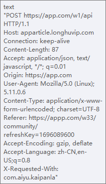

How do replace these with JSL with regex substitution?
This is copied in the browser. How to use JSL's regular substitution is processed into syntactic JSL with the following requirements:
1, contains POST......HTTP/1.1 replaced with: u="...";h=[=>];
2, containing:, write h
3. The last line..., replace with: jj="...";rs=New HTTP Request(URL(u),Method("POST"),JSON(jj),Headers(h));
Thanks!

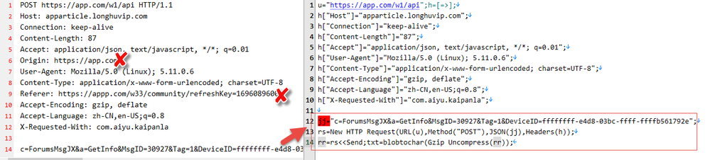

回复: How do replace these with JSL with regular substitution?
u="https://app.com/w1/api";h=[=>];
h["Host"]="apparticle.longhuvip.com";
h["Connection"]="keep-alive";
h["Content-Length"]="87";
h["Accept"]="application/json, text/javascript, */*; q=0.01";
h["User-Agent"]="Mozilla/5.0 (Linux); 5.11.0.6";
h["Content-Type"]="application/x-www-form-urlencoded; charset=UTF-8";
h["Accept-Encoding"]="gzip, deflate";
h["Accept-Language"]="zh-CN,en-US;q=0.8";
h["X-Requested-With"]="com.aiyu.kaipanla";
jj="c=ForumsMsgJX&a=GetInfo&MsgID=30927&Tag=1&DeviceID=ffffffff-e4d8-03bc-ffff-ffffb561792e";

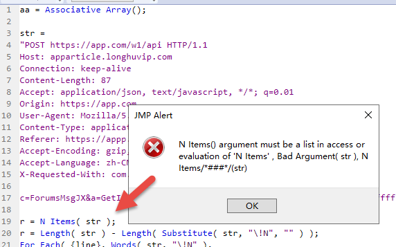

  • Continue asking: How can I get the total number of str lines?
Thanks Experts!

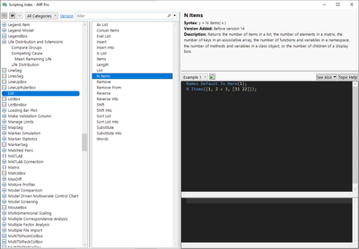

jthi
Re: How do replace these with JSL with regex substitution?
Scripting index
and JMP documentation N Items() has the information for you
-Jarmo
lala
Level IX
  • I still don't get it.
Thanks!
