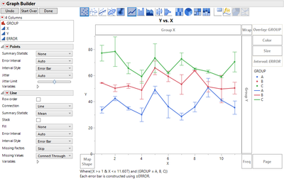

While Graph Builder allows multiple variables in the Y role, they all share the same Interval variable. Here's what I was able to get in JMP after stacking the variables into two columns, one for data and one for SD, and then using the SD column in the Interval role. I used the Local Data Filter to only show the three measures on interest and used a duplicated/split axis instead of your left/right axes.

Have you tried to assign your error column to the Interval variable in the Graph Builder window?
Also, if you have asymmetrical errors, you can assign two columns to the Interval variable to define the upper and lower boundaries of the error range.

Your Xs, Ys, and SDs need to be stacked (i.e., one column for each X, Y, and SD)

As noted previously in the link from Xan, when you have more than one overlay variable the "jitter" is too large.  As Thierry mentioned you need to stack your data.  Here's an example with two Y variables. Done in JMP 18 Early Adopter, but will work in versions 14, 15 and 16 as well.
Here's the graph.  Note the too-large jitter.  If someone knows how to remove the jitter please let us know!
Here's the code.
