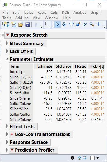

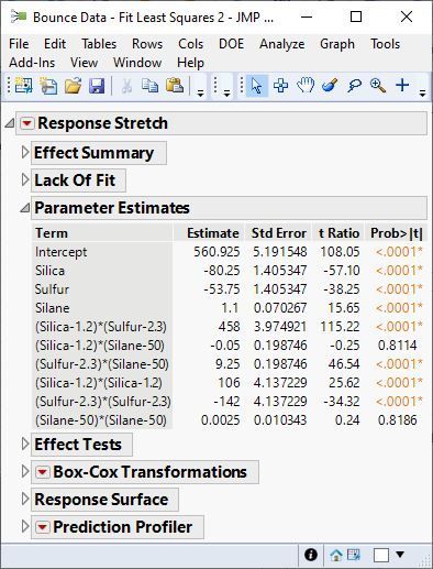

You should be able to match these estimates by first deleting the Coding column property and running the model again. Here is an illustration based on the Stretch Data in the sample data folder. Here are the coded estimates produced by default:
Here are the estimates after removing the Coding column property:
(Note that the factors were still centered but not scaled.)
