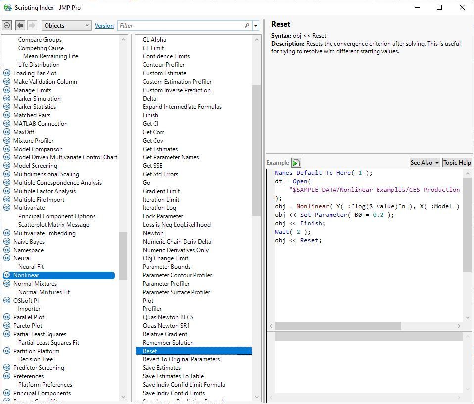

if it seems that a failure to converge requires a single Reset and Go, then your script could send the messages in succession to each sample. See the Scripting Index for Reset and Go messages.

Thank you sir, by clicking on Reset and Go, the data is being converged by Gradient criterion. But, what if I wanted to automize it in the script instead of resetting the graph because I wanted to use this output for further analysis. And only these samples are not being converged in the first attempt, so how to automize this using the script.
