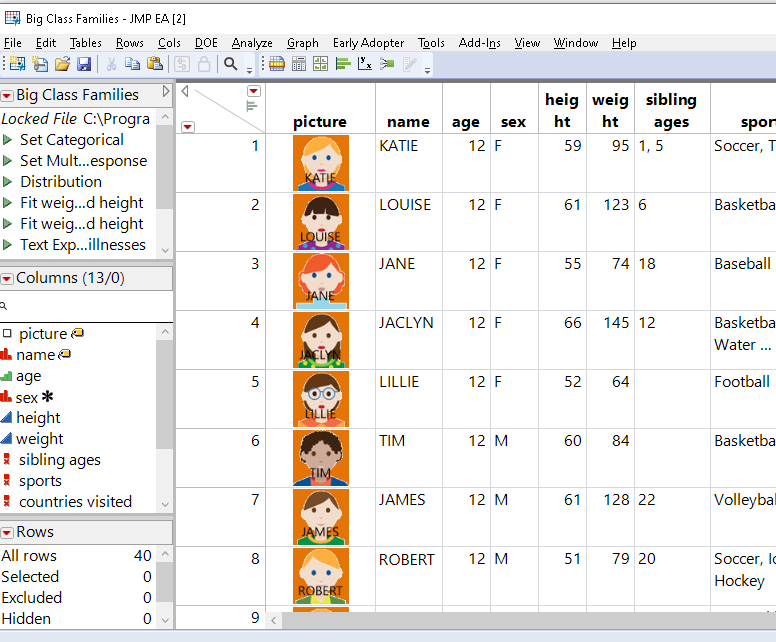

Craige_Hales
Re: How do add text to a cell that has an image loaded?
Add Text to a Picture
Use a graphics frame box to add text and lines on top of a picture.Use a graphics frame box to add text and lines on top of a picture.
Craige
Craige_Hales
dt = Open( "$SAMPLE_DATA/Big Class Families.jmp" );
For( iRow = 1, iRow <= N Rows( dt ), irow += 1,
// open the original
	original = dt:picture[iRow];
	{xSize, ySize} = original << size;
// use a frame to do the drawing, make the original fit the frame exactly
	gb = Graph Box(
		<<backgroundcolor( "orange" ), // to see errors better
		FrameSize( xSize + 1, ySize + 1 ), // the +1 is required, 4 times
		X Scale( 0, xSize + 1 ),
		Y Scale( 0, ySize + 1 ),
	// apparently x and y are different. this is correct in 17EA.
		<<Add Image( image( original ), bounds( top( 0 ), Left( 1 ), bottom( ySize ), Right( xSize + 1 ) ) ),
	// draw something on top of the image
		Text( Center Justified, {xSize / 2, 10}, dt:name[irow] );
// capture an updated image
	updated = gb[framebox( 1 )] << getpicture;
// crop added border. "updated" is the final image.
	updated << crop( Left( 1 ), top( 1 ), Right( xSize + 1 ), bottom( ySize + 1 ) );
	dt:picture[irow]=updated;
Mug shotsMug shots

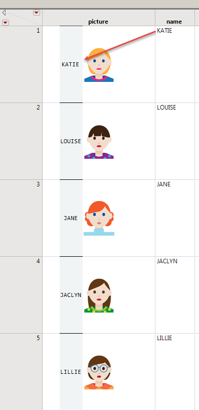

jthi
You could use set each value to re-create the image with text
Names Default To Here(1);
dt = Open("$SAMPLE_DATA/Big Class Families.jmp");
Column(dt, "picture") << Set Each Value(
	H List Box(align("center"),
		Text box(:name),
		:picture
	) << Get Picture
-Jarmo

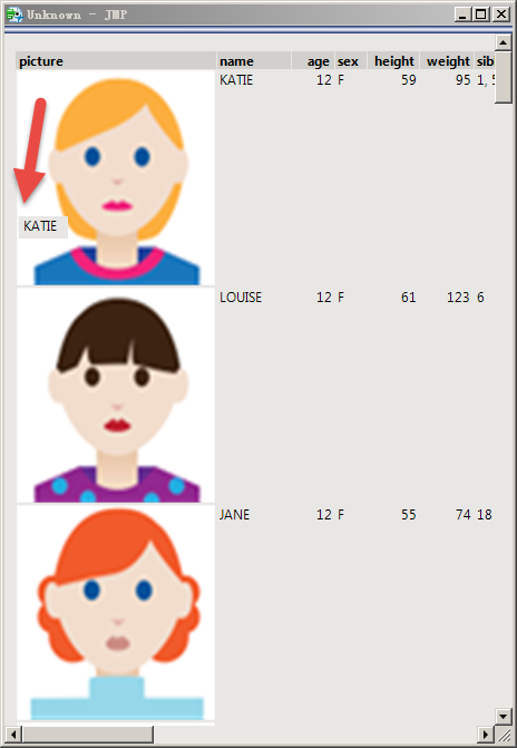

lwx228
Level VIII
If I want to add more than one cell of text, I try to add it left and right.
Can I add text below?It looks like this down here.

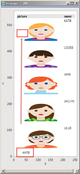

lwx228
Level VIII
Thank Craige!
I copied the following JSL, just to achieve the simplest function.
But I still don't know the code.Text is not added where it should be.
Consult experts to help modify, with the simplest code implementation.
Thanks Experts!
dt << delete columns( 3 :: N Col( dt ) );
dt << delete rows( 6 :: N Row( dt ) );
dt << Set Cell Height( 100 );
rp = New Window( "", dt << Get As Report );
original = rp << Get Picture;
gb = Graph Box(
	Text( Center Justified, { 50, 10}, "KATIE" )
originalMatrix = original << getpixels;
newMatrix = updated << getpixels;
diff = (originalMatrix - newMatrix != 0);
New Window( "bitmaps", V List Box( gb ) );
lwx228
Level VIII
  • How can this code be modified to fit inside the original image?

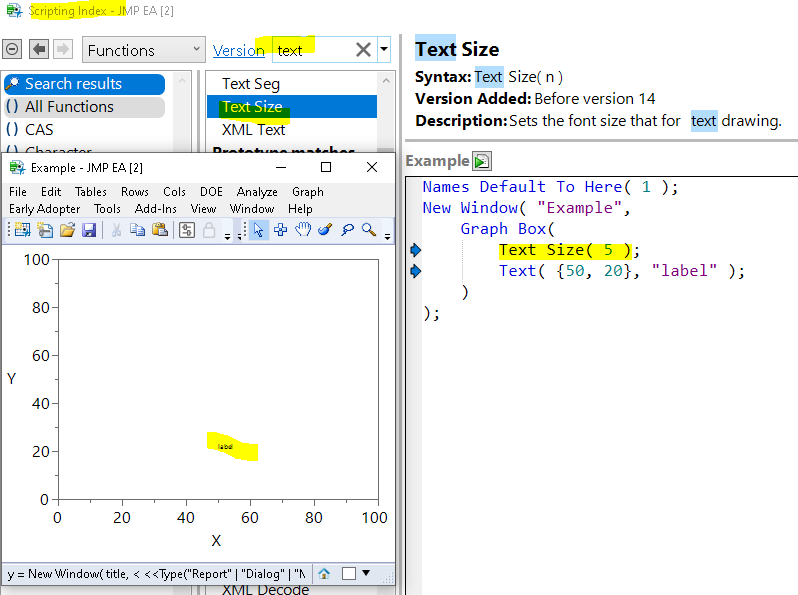

Craige_Hales
text size function; 5 points is a little too small for my eyes.text size function; 5 points is a little too small for my eyes.
Craige
Craige_Hales
Wait. You are using a picture of the whole data table, but I'm pretty sure you want to work on one picture at a time.
Just grab the image from dt:picture[iRow] rather than loading it from a file, then replace it when done. Approximately like this:
...existing jsl...
dt:picture[iRow] = updated;
