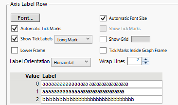

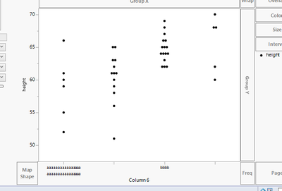

If you want to wrap them on axis, sometimes you might manage with axis settings Wrap Lines, but I think it wont wrap one long string without any whitespace
You might also end up with some missing labels when using this:

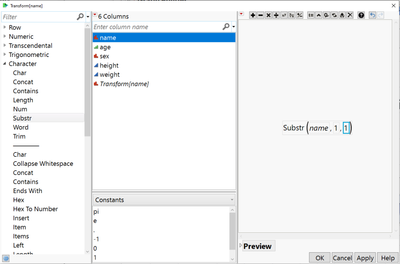

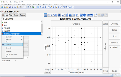

  • One is to make a Calculation (Transform) on that column in the Graph Builder (in your case you may need character function word to get a part of your column content, my formula was subtr(name, 1,1), that gives the first character, Based on data table "Big Class.jmp" from the Help-Sample Data menu
  • another would be to generate a new Column by "Recode" (right click on Column name ...)

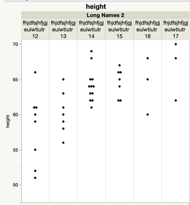

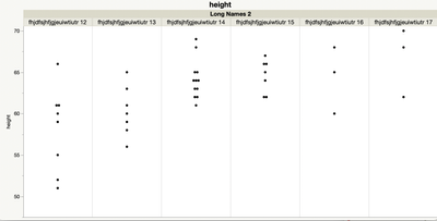

FWIW, when dropping a variable into the 'Group X' zone, I found that (JMP 16.2 on a Mac) Graph Builder did a reasonable job in breaking up the labels. And, if that's not to your taste, you can just drag to make changes to the widths:

Which version are you using now? I have JMP14 and there is not that option in Axis Label Row, but I will move soon at 15.
jthi
Re: How do I wrap in multiple lines the label of a Group X variable in Graph Builder?
It seems to be already in JMP15, but I'm using JMP16 so it might behave a little differently when compared to JMP15
