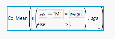

txnelson
Re: How do I use the Col Maximum Formula with a "where" condition
Apply an If() to the :weight column in the equation
col Mean( if(:sex=="M", :weight,.), :age)
Jim
hogi
Level XIII
Fantastic!
And so logic - when you see it!

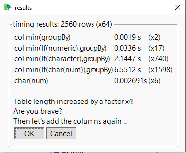

Hm, after some enthusiasm, I got a little grounded.
Seems that the if inside the Col Aggregation makes it very slow - especially if there is a character comparison inside the if - and especially x 2 if there is a char(num) conversion. Then the time scales ~ quadratic with increasing table size.
The good thing: Col Median (which I use most of the time) is not affected by this "bug" :)
Is there any easy solution for Col Min, max, mean ...?
If not, I will write a wish to implement an official way to calculate Col xyz  with a where condition ...
Would be much faster if the data set was first reduced (where) and then aggregated (Col xyz) and then the values distributed over all respective rows.

Names Default To Here( 1 );
If( Is Empty( mydt ),
	mydt = Open( "$SAMPLE_DATA/Big Class.jmp" )
trialRun = 0;
tryAgain = Function( {},
	trialRun += 1;
	Rownumbers = N Rows( mydt );
	t1 = HP Time();
	mydt << New Column( "col A", Formula( Col Mean( :weight ), :sex ) );
	t2 = HP Time();
	mydt << New Column( "col B", Formula( Col Mean( If( :age == 12, :weight, . ), :sex ) ) );
	t3 = HP Time();
	mydt << New Column( "col C", Formula( Col Mean( If( :sex == "M", :weight, . ), :age ) ) );
	t4 = HP Time();
	mydt << New Column( "col D", Formula( Col Mean( If( Char( :age ) == "12", :weight, . ), :age ) ) );
	t5 = HP Time();
	mydt << New Column( "col E", Formula( Char( :age ) == "12" ) );
	t6 = HP Time();
	tt1 = Round( (t2 - t1) / 1000000, 4 );
	tt2 = Round( (t3 - t2) / 1000000, 4 );
	tt3 = Round( (t4 - t3) / 1000000, 4 );
	tt4 = Round( (t5 - t4) / 1000000, 4 );
	tt5 = Round( (t6 - t5) / 1000000, 6 );
	If( trialRun == 1,
		tt1Ref = tt1;
		tt2Ref = tt2;
		tt3Ref = tt3;
		tt4Ref = tt4;
		tt5Ref = tt5;
		RNref = Rownumbers;
	tr1 = Round( tt1 / tt1Ref );
	tr2 = Round( tt2 / tt2Ref );
	tr3 = Round( tt3 / tt3Ref );
	tr4 = Round( tt4 / tt4Ref );
	tr5 = Round( tt5 / tt5Ref );
	RNratio = Round( RowNumbers / RNref );
	Wait( 0.1 );
	Try( mydt << delete columns( "col A", "col B", "col C", "col D", "col E" ) );
	Wait( 0.1 );
	mydt = mydt << Concatenate( mydt, mydt, mydt );
	Wait( 0.1 );
	If(
		ex = New Window( "results",
			<<Type( "Modal Dialog" ),
			<<Return Result,
			V List Box(
				Panel Box( "timing results: " || Char( Rownumbers ) || " rows (x" || Char( RNratio ) || ")",
					Lineup Box( N Col( 3 ),
						Text Box( "col min(groupBy)" ),
						Text Box( Char( tt1 ) || " s" ),
						Text Box( "(x" || Char( tr1 ) || ")" ),
						Text Box( "col min(If(numeric),groupBy)" ),
						Text Box( Char( tt2 ) || " s" ),
						Text Box( "(x" || Char( tr2 ) || ")" ),
						Text Box( "col min(If(character),groupBy)" ),
						Text Box( Char( tt3 ) || " s" ),
						Text Box( "(x" || Char( tr3 ) || ")" ),
						Text Box( "col min(If(char(num)),groupBy)" ),
						Text Box( Char( tt4 ) || " s" ),
						Text Box( "(x" || Char( tr4 ) || ")" ),
						Text Box( "char(num)" ),
						Text Box( Char( tt5 ) || "s" ),
						Text Box( "(x" || Char( tr5 ) || ")" ),
					Text Box( "\!nTable length increased by a factor x4!\!nAre you brave?\!nThen let's add the rows again ..." ),
					H List Box( Button Box( "OK" ), Button Box( "Cancel" ) )
		ex["button"] == 1;
		tryAgain()
tryAgain();

Fun Fact:
searching for "M" in a list of strings  is orders of magnitude faster than comparing "M" with a string:
	write ("\!nrows: ", nrows(mydt),"\!n");
	t0 = HP Time();
	mydt << New Column( "char=char", Formula( Col Mean( If( :sex == "M", :weight, . ), :age ) ) );
	t=(HP Time()- t0)/1000000;
	write("char=char: ",t,"\!n");
	t0 = HP Time();
	mydt << New Column( "contains", Formula( Col Mean( If( contains(Eval List({:sex[]}) ,"M"), :weight, . ), :age ) ) );
	write("contains: ",t,"\!n");
	If(
		ex = New Window( "",
			<<Return Result,
			V List Box(
					Text Box( "\!nTable length increased by a factor x4!\!nAnother step - are you brave ?" ),
		ex["button"] == 1;
		tryAgain()
tryAgain();
why?!?
Which secret is behind this finding?
