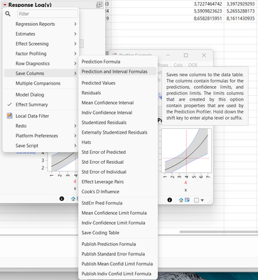

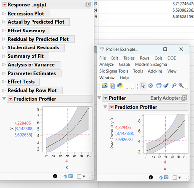

I'm not sure how you have saved the prediction and intervals formula for the log-transformed response, but I can have the same results between Fit Model Profiler platform and the Prediction Profiler (graph) platform :
When you have fitted your model on the log-transformed model, did you save correctly the prediction and intervals formula ? :
When I do this and then launch the Profiler with the newly saved Prediction Formula, I can get the same results.
