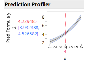

I fit a log transformed model in script #3. When I try to reproduce the profiler generated by script #3 using Graph>Profiler as before, the confidence intervals appear to be incorrect
I manually calculated the confidence intervals (see columns in table) produced in script #3 and #4 using the "Prediction Formula" and "StdErr Pred Formula" from script #3. It seems script #3 is doing something like this in the background: ":Pred Formula y 2 * Exp( t Quantile( 0.025, 2 ) * :"PredSE Log(y)"n )". Meanwhile script #4 for is doing something like this in the background: ":Pred Formula y 2 + t Quantile( 0.025, 2 ) * :"PredSE Log(y)"n".

Script #3 Profiler (Analyze>Fit Model, log y transform)
Script #4 Profiler (Graph>Profiler, log y transform)

I'm not sure how you have saved the prediction and intervals formula for the log-transformed response, but I can have the same results between Fit Model Profiler platform and the Prediction Profiler (graph) platform :
When you have fitted your model on the log-transformed model, did you save correctly the prediction and intervals formula ? :
When I do this and then launch the Profiler with the newly saved Prediction Formula, I can get the same results.
