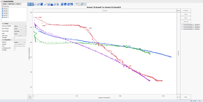

Dragging and dropping x and y values for multiple series data sets gives the following graph
I want to see only SeriesA Y vs SeriesA  X,
SeriesB Y vs SeriesB X
SeriesC Y vs SeriesC X
I do not want to see the curves for SeriesA Y vs SeriesB X   etc...

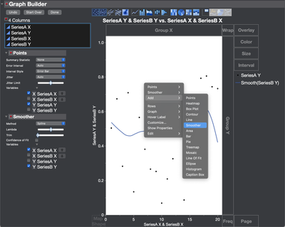

Stacking the data, as @Dan_Obermiller suggests is one way to make this easy and may be the best way to have your data arranged for other analyses, but you can get the graph you want without rearranging the data.

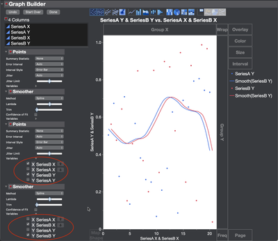

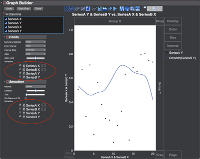

Instead, just as with Excel you can change the variables used for the individual elements (points and spline in this case) using the elements panel on the left of the graph. Just open the Variables section and pick which variables you want to use for each element.
Then you can add another spline and another points element by right-clicking in the graph and set them to the next series.
