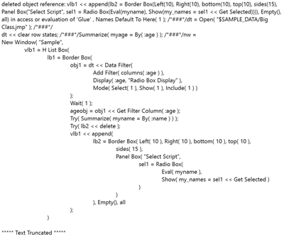

If you comment out all of vlb1, you get a small box that you can select from the different ages in Big Class. The other rows are excluded and hidden.
Problems:
  1. The second summarize, namelist, is not dynamically updating with different age selection. How can the script be updated to do this?
    1. The second Try() is from the solution code and is dynamic, so I'm not sure why the first one wouldn't be.
  2. JMP errors out when the vlb1 is uncommented, error picture below. I'm not sure where the deleted object reference is in this part of the code. Can anyone see it?
I think if these two can be solved, then I should be able to find some way to return a single row number.
Learning every day!
