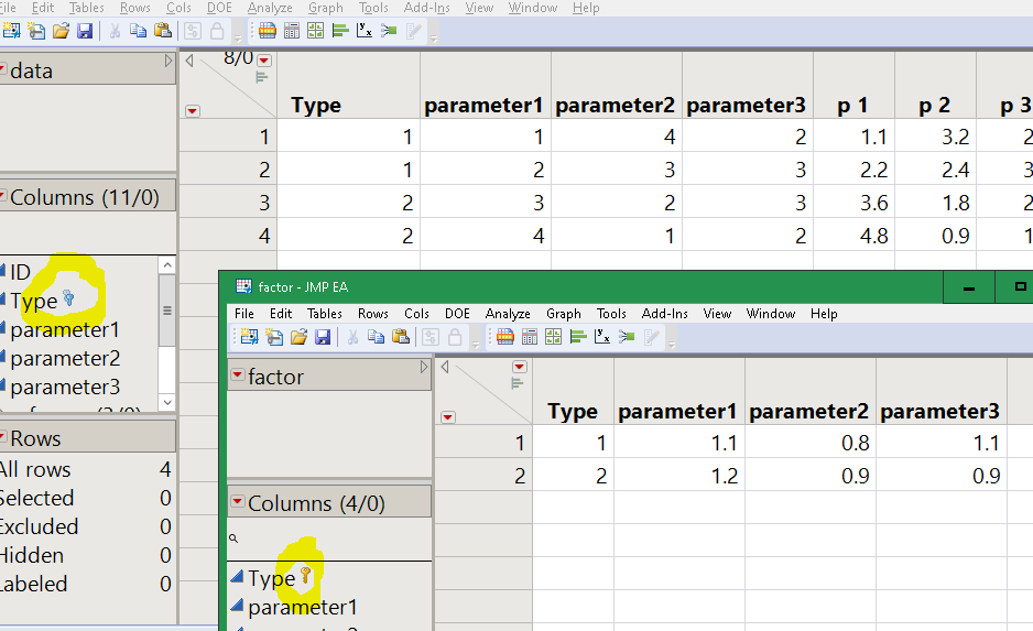

Craige_Hales
Re: How do I multiply two tables together
You could use a virtual join and formula columns.
Virtual join adds the blue and gold keysVirtual join adds the blue and gold keys
You can link them interactively or with JSL.
This may be using JMP16 names with the  :"parameter3[Type]"n syntax; you might need name("parameter3[Type]") instead.

factorDT:type << Set Property( "Link ID", 1 );
dataDT:type << Set Property( "Link Reference", Reference Table( "factor.jmp" ) );
// add formula columns
dataDT << New Column( "p 1", Numeric, "Continuous", Format( "Best", 12 ), Formula( :"parameter1[Type]"n * :parameter1 ) );
dataDT << New Column( "p 2", Numeric, "Continuous", Format( "Best", 12 ), Formula( :"parameter2[Type]"n * :parameter2 ) );
dataDT << New Column( "p 3", Numeric, "Continuous", Format( "Best", 12 ), Formula( :"parameter3[Type]"n * :parameter3 ) );
// force the evaluation to complete
dataDT<<RunFormulas;

dt1 << sort( by( :type ), order( ascending ), replacetable );
type2Begin = Contains( dt1:type << getasmatrix, 2 );		//row # of first occurrence of type == 2 in sorted table.
//build matrices that show where row & column divisions of "blocks" will be
rowBreaks = (1 :: N Row( dt1 ) :: blockRowLimit) || Matrix( type2Begin ) || Matrix( N Row( dt1 ) );
rowbreaks = rowbreaks[Rank( rowbreaks )]; //sort the matrix
colBreaks = (3 :: N Col( dt1 ) :: blockColLimit) || Matrix( N Col( dt1 ) );
colBreaks = colBreaks[Rank( colBreaks )]; //sort the matrix
nrowBreaks = N Row( rowBreaks );
ncolBreaks = N Row( colBreaks );
For( i = 1, i < nrowBreaks, i++,
	lowRow = rowBreaks[i];
	highRow = if ( i == nRowBreaks - 1, rowBreaks[i+1], rowBreaks[i+1] -1 ); //we don't need to subtract 1 off the last upper bound.
	rowRange = lowRow :: highRow;
	If( rowrange[1] < type2Begin, factorRow = 1, factorRow = 2); //determine which row of factors we'll work with for this row range of data
	For( j = 1, j < ncolBreaks, j++,
		lowCol = colBreaks[j];
		highCol = if ( j == ncolBreaks - 1, colbreaks[j+1], colbreaks[j+1] -1 );  //we don't need to subtract 1 off the last upper bound.
		For( c = lowCol, c <= highCol, c++,
			dt1[rowRange, c] *= dt2[factorRow, c - 1]   // -1 because dt1 has an ID column while dt2 does not
