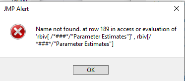

I've got a standard YvsX dataset, but with 4 different 'group by' columns. When I try to do the extraction (I've tried a lot of different methods), i keep getting errors like this:
Any Idea what's up with this? I've tried concatting the four cols into a single column and then splitting by that single concat and still get errors.

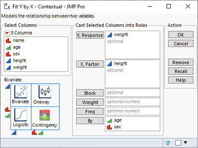

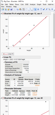

Using Big Class.jmp and Fit Y by X with selections like this:
Provides me with output:

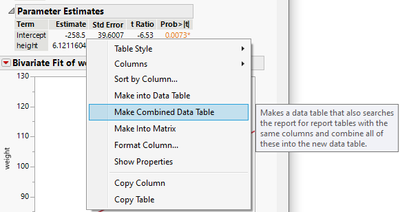

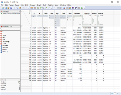

When I right click on the Table Box inside Parameter Estimates and select "Make Combined Data Table" I get following table:
From there I can delete all rows and columns which I'm not interested in.
You can also get the script from table script
