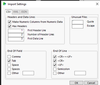

jthi
Re: How do I import .txt file with several rows of column header
I think you might be able to do it with Multiple File Import (depending on your data). Change Settings and modify CSV import settings as needed

jthi
