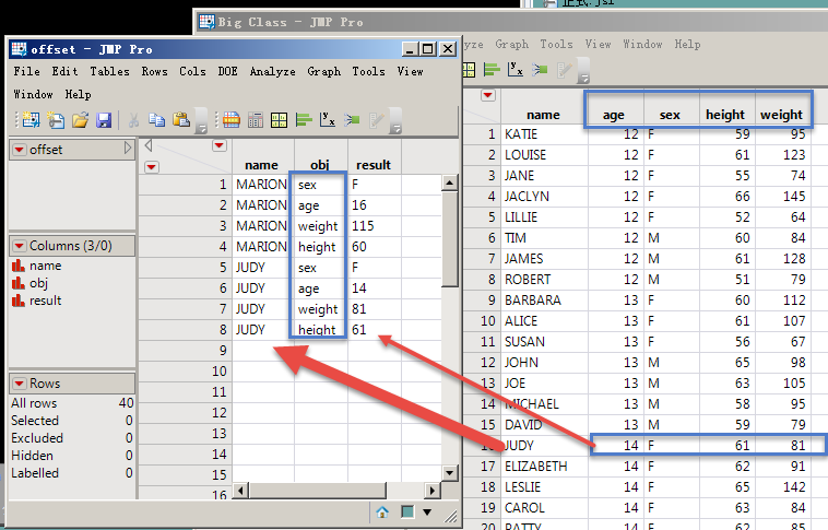

Please continue your guidance:how to extract the value by matching both names simultaneously, like the offset function in excel.Thank you very much!

Re: How do I implement an excel like VLOOKUP using JSL?
It looks like you want to stack columns. Explore the Stack() command. However, in your example you have stacked columns of different data types (Character and numeric), which will not work unless data types are harmonized first.
Thank you. That's a very efficient way. I'll keep that in mind.
But what if I only needed code to extract the data for the eight line names I gave?Want to learn one more way.
There are several ways. One is to simply delete unwanted rows from the stacked table.
d1 = Open("$SAMPLE_DATA/Big Class.jmp");
d2 = d1 << Stack(Columns(:age, :sex, :height, :weight));
d2 << delete rows(d2 << get rows where(:name != "MARION" & :name != "JUDY"));
Or just make a subset. The example below is without stacking (in JMP, it's rarely a good idea to mix widely different variables in the same column).
d1 << Subset(rows(d1 << get rows where(:name == "MARION" | :name == "JUDY")));
