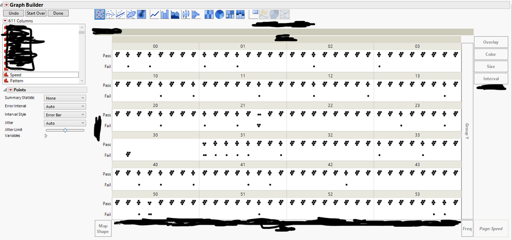

How do I get these dots back into a vertical orientation instead of a "cluster" shown here? The 4-5 dots used to be vertically aligned. Using JMP 16.

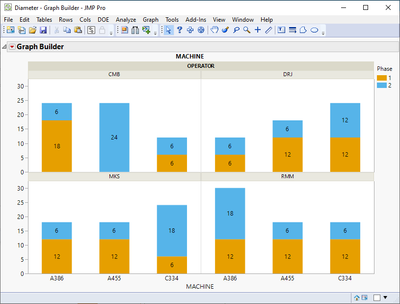

I think changing Jitter settings is only option you have if you want to use Points. Could it be possible to use other visualization such as bar chart?
Instead of

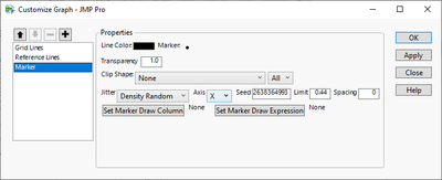

You can use Customize menu to change Marker's Jitter settingsin more detail (especially Axis and Jitter type)

Found it. Changing the data type of the x-axis column from numeric to character causes the arrangement of the points to change from vertical to "cluster" as previously shown.
Instead of
