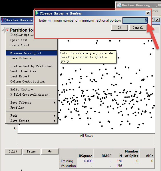

How do I get the default "minimum Size Split" in a decision tree using JSL?
Hello, everyone!
I want to use JSL get the default "minimum Size Split" in a decision tree .
Thanks you!

It seems that internally when the Minimum Size Split in preferences is unchecked ( <<Off ) the default that appears in the options is 5. If the user's Platform Preferences for Partition is set the set value will be used for both the prompt window you displayed as well as the application, unless it is changed.
If you do not want the user's preferences, specify Partition(Y(), X(), Ignore Platform Preferences(1) );
If you ignore platform preferences, you will need to modify the script below and assume the default minimum size is 5.
Here is a script to capture if the user set the preference from the Preferences UI or Partition UI.
