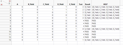

Hi,
New to JMP and have searched and read loads of help and going around in circles. I would think what I am doing is easy and straight forward but not getting that feeling from JSL. I have a more complicated data table but for the purpose of trying to get my code to work I have simplified my table. I have a table with 5 columns, 4 of each have "_Yield" in the heading. 13 rows consist of 1's and 0's and what I am trying to do is create a column for each row that shows the first occurrence of a 1 in the yield columns. I need this to be smart as the column names (other than contain _yield) will not always have the same names or be in the same locations. I have figured out how to just look at the yield columns and have converted this to a matrix where I can then find the values I am looking for. I just cant convert these values into the column headers. The test column shows position in matrix, the result column below shows what I should be getting in the Help column.  Thanks in advance.

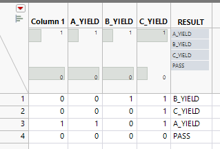

Re: How do I get items from a list to output a value from another list ?
One example:
Names Default To Here(1);
dt = New Table("Untitled",
	Add Rows(3),
	New Column("Column 1", Numeric, "Continuous", Format("Best", 12), Set Values([0, 0, 1, 0])),
	New Column("A_YIELD", Numeric, "Continuous", Format("Best", 12), Set Values([0, 0, 1, 0])),
	New Column("B_YIELD", Numeric, "Continuous", Format("Best", 12), Set Values([1, 0, 0, 0])),
	New Column("C_YIELD", Numeric, "Continuous", Format("Best", 12), Set Values([1, 1, 1, 0]))
// Get column names which end in _YIELD
yield_cols = Filter Each({col_name}, dt << Get Column Names("Continuous", "String"),
	Ends With(col_name, "_YIELD");
// create new column to get _YIELD column name
dt << New Column("RESULT", Character, Nominal, << Set Each Value(
	one_idx = Loc(dt[Row(), yield_cols], 1);
	If(N Items(one_idx),
		yield_cols[Min(one_idx)];
		"PASS"
-Jarmo
Hi jthi,
Thanks for your reply. Filter Each isn't an active function for me. Maybe because I am using V15 but I was able to use my current way of selecting column names with your one_idx  equation and it works a treat. I had been struggling with the Loc function last week so this really helps.
