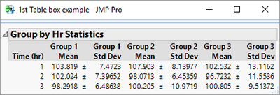

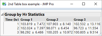

I have attached a script that illustrates how to do the 3 different solutions for your request.  I think the 3rd one is the closest to what you want.

Re: How do I create a summary table with mean ± SD in the same column?
Thank you, Jim. The third option is exactly what I am looking for. How do I arrive at this format? I have very little experience creating data tables using JMP.
