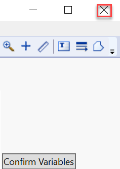

Is there a way to script to close all windows opened through a user interface I created upon hit the cross button sitting on the top right of my interface window?

You can use the On Close() feature for a window, to run a script that can close windows.  If you want to close all windows, you can loop through all open windows and close them.  If you want to close only the windows that were opened by your application, then I suggest that you create a list in your application that keeps track of the windows that open, and then in the On Close() section, you loop through that list.
Jim
Re: How do I close a report window?
Lists generally distribute a message sent to them to all the items. You might simply have to send the << Close Window message to the list of window references.

It works. Thank you sir!
