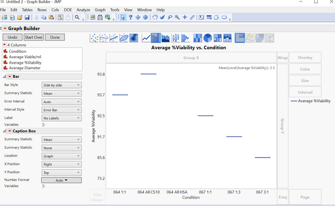

I am trying to make normal bars on my graph instead of dashes but I don't know where to adjust the setting. See picture attached. I have JMP version 17.

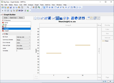

Nominal:

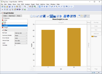

Continuous:
