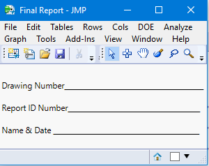

I'm looking to create header for my JMP reports with information like this
I have all the information in my data table, but can´t get it to any journal or report, please guide me to the code

Run the below script.  It has a simple input screen, it then creates a header and a simple report output.  Study the script and then you should be able to go develop your own version

nw = New Window( "My Output",
	Border Box( top( 10 ), Left( 10 ), Right( 10 ), bottom( 10 ), sides( 15 ),
		V List Box(
			Spacer Box( size( 1, 10 ) ),
			Text Box( "Drawing Number " || dNumber ),
			Text Box( "Report ID Number " || Char( rIDNumber ) ),
			Text Box( "Name & Date " || nameAndDate ),
	bivariate( x( npn1 ), y( pnp1 ) )
