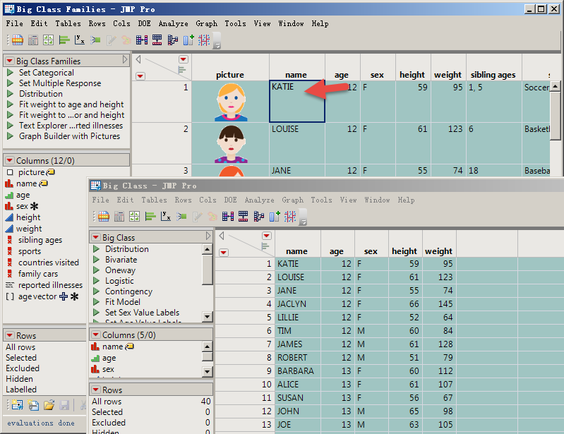

I have multiple files open at the same time and their window positions overlap.Files with Windows on top block files with Windows on bottom.
For example, file "Big Class Families.jmp" is the file that is being edited,
but I want to keep the window of file ""Big Class.jmp"", which is not properly edited, at the top of the window all the time.
Thanks Experts!

The window you are editing is always force to be the top window,
Jim
