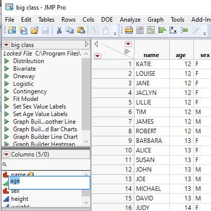

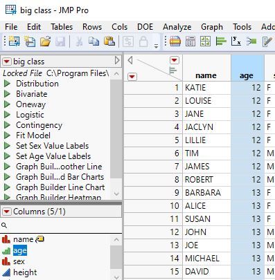

  1. Go to the Columns Panel on the left side of the data table and click on the column name you want to copy. cl1.JPGPause and then click on it again.  The display will change to a field that you can now copy from.cl2.JPG

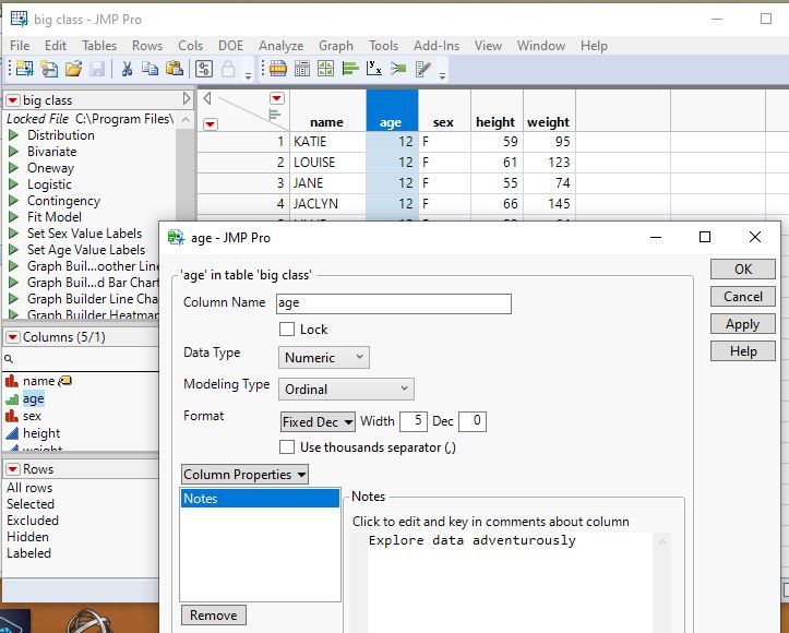

  2. Double click on the column header, which will open up the Column Info dialog box.  You can copy the column name from there.cl3.JPG
