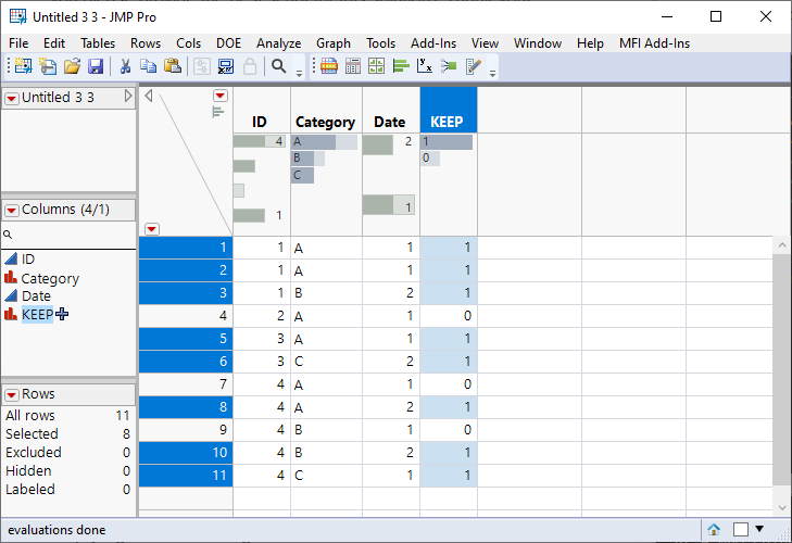

jthi
Re: How can I select rows based on multiple conditions for the same ID?
Here is one way you could approach this using Col-functions
Names Default To Here(1);
dt = New Table("Untitled 3",
	Add Rows(11),
	Compress File When Saved(1),
	New Column("ID", Numeric, "Continuous", Format("Best", 12), Set Values([1, 1, 1, 2, 3, 3, 4, 4, 4, 4, 4])),
	New Column("Category", Character, "Nominal", Set Values({"A", "A", "B", "A", "A", "C", "A", "A", "B", "B", "C"})),
	New Column("Date", Numeric, "Continuous", Format("Best", 12), Set Values([1, 1, 2, 1, 1, 2, 1, 2, 1, 2, 1]))
dt << New Column("KEEP", Numeric, Nominal, Formula(
	Col Sum(Row() == Col Min(Row(), :category, :id), :id) > 1 & :date == Col Max(:date, :category, :id)
Change the formula to << Select Where / << Get Rows Where or use it with subset to take the rows you want to keep.
Edit:
Original version didn't take into account that category 1 could be missing (this assumes that category is numerical column)
	& Col Sum(If(:category == 1, 1, .), :id)
-Jarmo
