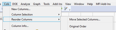

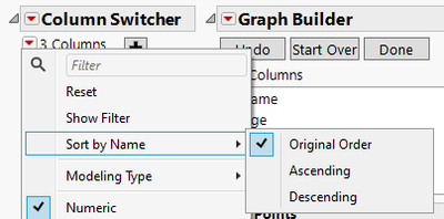

I think with column switcher you either have to rely on column order of the table or alphabetical ordering
I'm not sure what Original Order means in this case though as it might have different meaning when we are talking about columns in a JMP table
but I think in the case of column switcher it might be "Table Order" and not Original Order.
For JMP Table
Using JMP > Enter and Edit Your Data > Organize Data in Data Tables > Rearrange Columns in Data Tabl...
Original Order
Returns the columns to the order they were in when data table was last saved.
