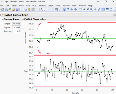

Hello,
I have a table where I exclude certain rows and then perform an EWMA on it. I would like the excluded regions not to be displayed, as is done for control charts with the “show excluded regions” option. Except that I don't see such an option for EWMA, unless I'm mistaken? Is there another option? I would like to avoid creating a subset as much as possible; I would like to stay on the same table.
Names Default To Here( 1 );
dt = Open( "$SAMPLE_DATA/Quality Control/Clips1.jmp" );
dt << Clear Select << Select Rows( Index( 6, 13 ) ) << Exclude;
dt << clear select();
obj = dt << EWMA Control Chart( Y( :Gap ) );

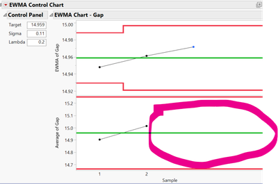

Hello, thank you for your response ! Indeed, but it shows white space it does not rescale automatically for instance:

Re: Hide excluded regions in EWMA chart
Yes and I have still the whitespace issue. But is seems to be corrected, I have JMP 18.0.0 but for my colleague in 18.0.1 the same script gives different results and works as I wanted, without whitespace
