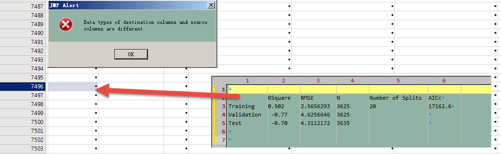

How can I paste a data table with text mixed in the clipboard into the specified table?
 The clipboard has copied the R square table in the decision tree report, 6 rows and 6 columns, containing text. How can I paste this table into the new table?
thank you!
  RSquare RMSE N Number of Splits AICc
Training 0.502 2.5656293 3625 20 17162.6
Validation -0.77 4.6256646 3625
Test -0.70 4.3112172 3635

The first column of the table you copied contains the group names "Training", "Validation", "Test", text.  You are trying to paste it into a column that is numeric, not a string. Note the dot a symbol represents an empty numeric column.
JMP maintains data types for the entire column.  JMP tables are like database tables, you do not find a person's name isn some row of a column that is expected to be their phone number.  Excel, Statistica, old RS/1 are display tables. They allow the preamble of the US constitution in cell A1 and today's temperature in cell A2.

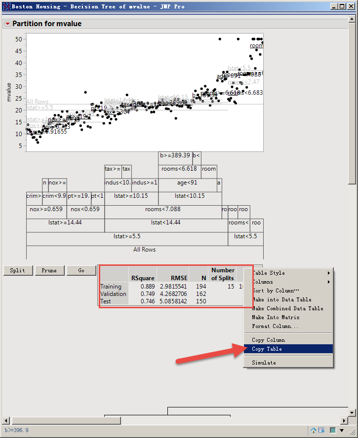

Complete with this description:
I have copied the R side report of the decision tree to the clipboard with JSL provided by Jim.
Names Default To Here( 1 );
dt = Open( "$SAMPLE_DATA\Boston Housing.jmp" );
pp = dt << Partition(
Y( :mvalue ),
X(
:crim,
:zn,
:indus,
:chas,
:nox,
:rooms,
:age,
:distance,
:radial,
:tax,
:pt,
:b,
:lstat
Split Best( 3 )
Report( pp )[Table Box( 1 )] << copy data;
I tried many ways to paste the contents of the clipboard into the specified table without success.
text = Get Clipboard();
dt[7496,11]= Get Clipboard();
Please kindly advise.thank you!
