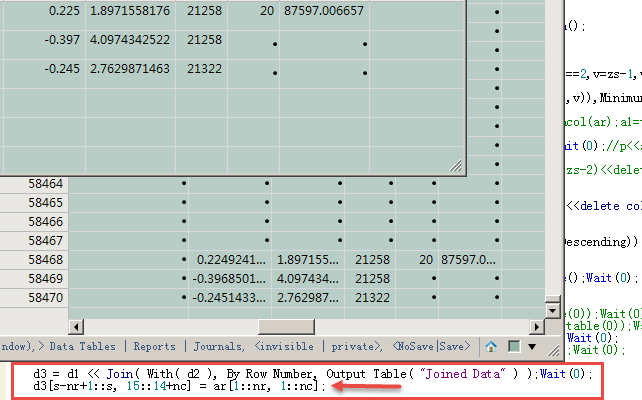

I have a table merge in my code, and I want to write R squared at this point.But that's not the main thing.
d3 = d1 << Join( With( d2 ), By Row Number, Output Table( "Joined Data" ) );
I'm used to VBA, so I haven't adjusted my thinking.thank Jim!

I am not quite sure what you are attempting to ask.  My thinking is that you have 2 lines that are attempting to serve the same purpose.  The first line uses a JMP Join Platform to add a data table to an already existing data table.  Is the second line attempting to replace values in the dt3 data table?

Thank you, Jim, for your continued attention. Sorry, I haven't done this problem and it has been solved. This figure is the actual effect I got with the method provided by the gzmorgan0.
In the process, I combined multiple data tables, and then wrote the data of R square into a fixed empty cell, which can be accurately found in the VBA processing in the later stage.
