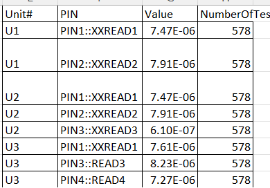

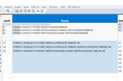

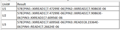

I want to use jsl to split data in column "result" with delimiter "|" to new column "PIN" and "value". Kindly help, thank you in advance
Please refer my attachment
new table

Given the data table
This JSL will produce the required new table

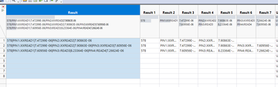

// Convert the Result column into several columns
// Text to columns
dt << Text to Columns(
	columns( :Result ),
	Delimiters( "|" )

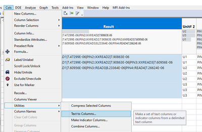

Split a Data Table Column into Multiple Columns (jmp.com)
Select your column
go to columns menu
set your delimilter
press OK and you have your result
copy script from enhanced log / workflow and modify it as needed
// Text to columns
Data Table("Sheet1") << Text to Columns(columns(:Result), Delimiters("|"));
