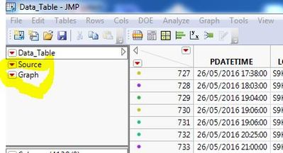

How can I create a JSL script for saving a graph to the data table.
I have a scheduled script running daily which saves out a data table.
However I would like to include graphs which I can do manually and save to data table.
Is there away of putting this into the script ?
Any help appreciated.

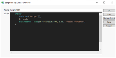

Re: How can I create a JSL script for saving a graph to the data table.
Hi @txnelson, can you help me rewrite my code below? I want to create a JSL which can do the TOST for selected column named "XXXX", and then save the Script to JMP Table. There are some problems in the code below, firstly I need to put the XXXX twice in the code below which is not efficient, and also in the future I want to replace XXXX with a list so that I can do many analysis at once. Secondly I want to replace STD3X with an actual number in the script not a variable. I tried to modify it based on @Mark_Bailey 's code below, but it's not working. Could you please help me? Thank you so much.
dt = Current Data Table();
dt << New Script(
	"XXXX-TOST",
	ColName = "XXXX";
	STD3X = 3 * Col Std Dev( If( :"Size" == "Small", :Column( ColName ) ) );
	Oneway(
		Y( :Column( ColName ) ),
		X( :Scale ),
		Unequal Variances( 1 ),
		Std Dev Lines( 1 ),
		Equivalence Tests( STD3X, 0.05, "Pooled Variance" )
jthi
Few questions:
  1. Selected column named "XXXX". Is this really selected column from table or just column name which will be pre-scripted?
  2. Putting XXXX twice. You mean in the table script name and then as column name? When you have a list, how should the table script be named? How long list may it be?
  3. STD3X with an actual number in the script not a variable. I'm not sure what is meant by this? Isn't it already number which is being calculated based on your data?
  4. Not as important as questions above: how is the script being built/run?
This won't handle list of column names, as I'm not sure what should be done with that list
Names Default To Here(1);
col_of_interest = "height";
std3x = 3 * Col Std Dev(If(:sex == "F", Column(col_of_interest)));
table_script_expr = EvalExpr(
	Oneway(
		Y(Expr(Column(col_of_interest))), X(:sex), Equivalence Tests(Expr(std3x), 0.05, "Pooled Variance");
Eval(
	Substitute(
		Expr(dt << New Script(Eval Insert("^col_of_interest^-TOST"), _table_script_)),
		Expr(_table_script_), Name Expr(table_script_expr);
-Jarmo
lazzybug
Level III
@jthi Thank you so much, this is exactly what I want. You are the best!!!

Sorry for making it not very clear what I am asking, I will try and go through this step by step here.
1) I have a scheduled script running daily which saves out a data table, no problems here.
2) In the data table, manually or using script I create a "graph",
   Then manually I can for that "graph" -  "Save the script to data table" which then saves the graph to the data table, then when the data table is saved and then opened again the script can be easily opened / Ran.
Question is can this be scripted before saving the data table and is the "New script" option the way of doing this ?
Hope this helps.
