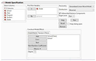

Because your response is a count, it should properly be modelled with a Poisson distribution. You also have random effects, so that would be a Generalized Linear Mixed Model, which is now possible in JMP Pro 17.
I suspect that Bee should be nested within Hive. There is a very similar example with nested random effects in the help documentation for JMP (Pro) 17.
I hope this helps.
