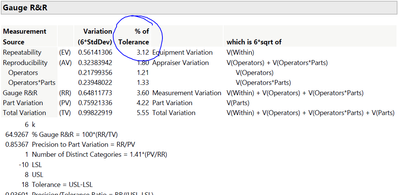

I am working with the GR&R analysis tool and need to get the % of Tolerance column in the results table. Something like this
But when I right-click on the Gauge R&R to show this column, the only available columns to are these items
Do you have any idea how to get the % of Tolerance column?

You need to specify the tolerance range prior to running the Measurement System Analysis.
