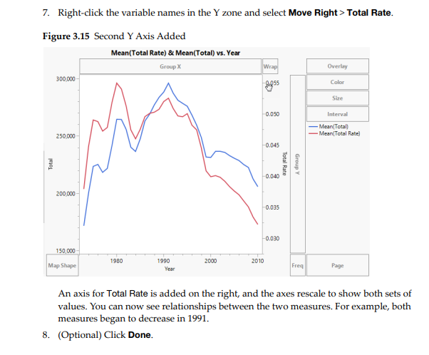

How can I add a second y-axis in graph builder?
Hi everyone!
I´m a recently started JMP user, and I´m now preparing some time profile plots using the ¨Line Option¨ in the Graph Builder. I need to show two different variables with independent y-axes and scales in a single plot, but I don´t know how to add the second axis at the right side. I wonder If can get help on how to do that. Thanks in advance,

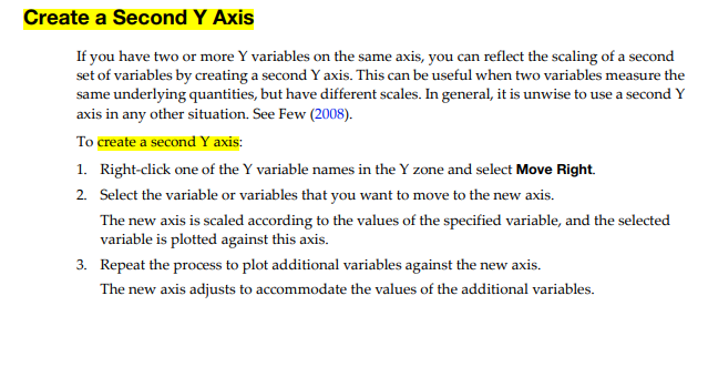

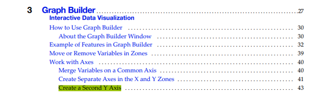

This is very nicely covered in the Essential Graphing document found in the JMP Document Library under the Help pull down menu.

Hi txNelson. Thanks for your help! I appreciate it! Now I was able to add a 2nd y-axis to my graph! :)
