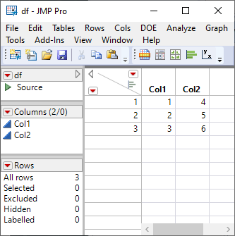

Update:
I think the problem is isolated on Python Send or Python Execute as JMP is trying to send the data to python. Creating the data in python and getting it into JMP works.
Python Init();
Python Submit("\[
df = _JMPpd.DataFrame({"Col1": [1, 2, 3],
	                   "Col2": [4, 5, 6]})
print(df)
x = _JMPnp.array([1,2,3])
print(x)
dt = Python Get(df);
Show(dt);
dt << New Data View;
x = Python Get(x);
Show(x);
Python Term();
And it works just fine:
   Col1  Col2
0     1     4
1     2     5
2     3     6
[1 2 3]
dt = DataTable("df");
x = [1 2 3];
0
