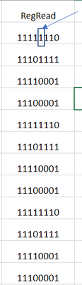

Hi, I have been trying to find a way to read one bit in an 8-bit code (column RegRead) to be used to create a new column.
I can't seem to know to do it. in this example below, I am trying to ready bit[3], can someone help with it
much appreciated.
Ray

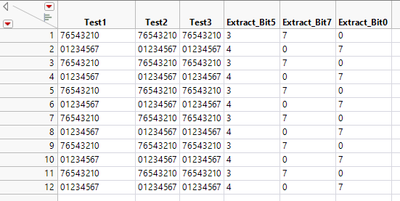

you gave the idea to use SUBSTR() function and I tested it out with random columns Test1,2,3
dt << New Column ("Extract_Bit5", formula(SUBSTR(:Test1, 5, 1)));
dt << New Column ("Extract_Bit7", formula(SUBSTR(:Test2, 1, 1)));
dt << New Column ("Extract_Bit0", formula(SUBSTR(:Test3, 8, 1)));
results
results
