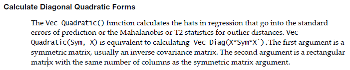

Yes, I can show you how JMP performs the Vec Quadratic() calculation. Here is a direct excerpt from the guide:
Select Help > Books > Scripting Guide. Then press CTRL-F and enter "quadratic(" for the search string. Very easy.

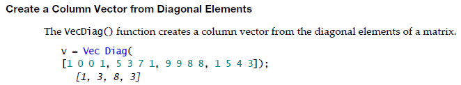

Using the same simple technique, I found the answer to your next question:
This entry is right above the one for Vec Quadratic().
